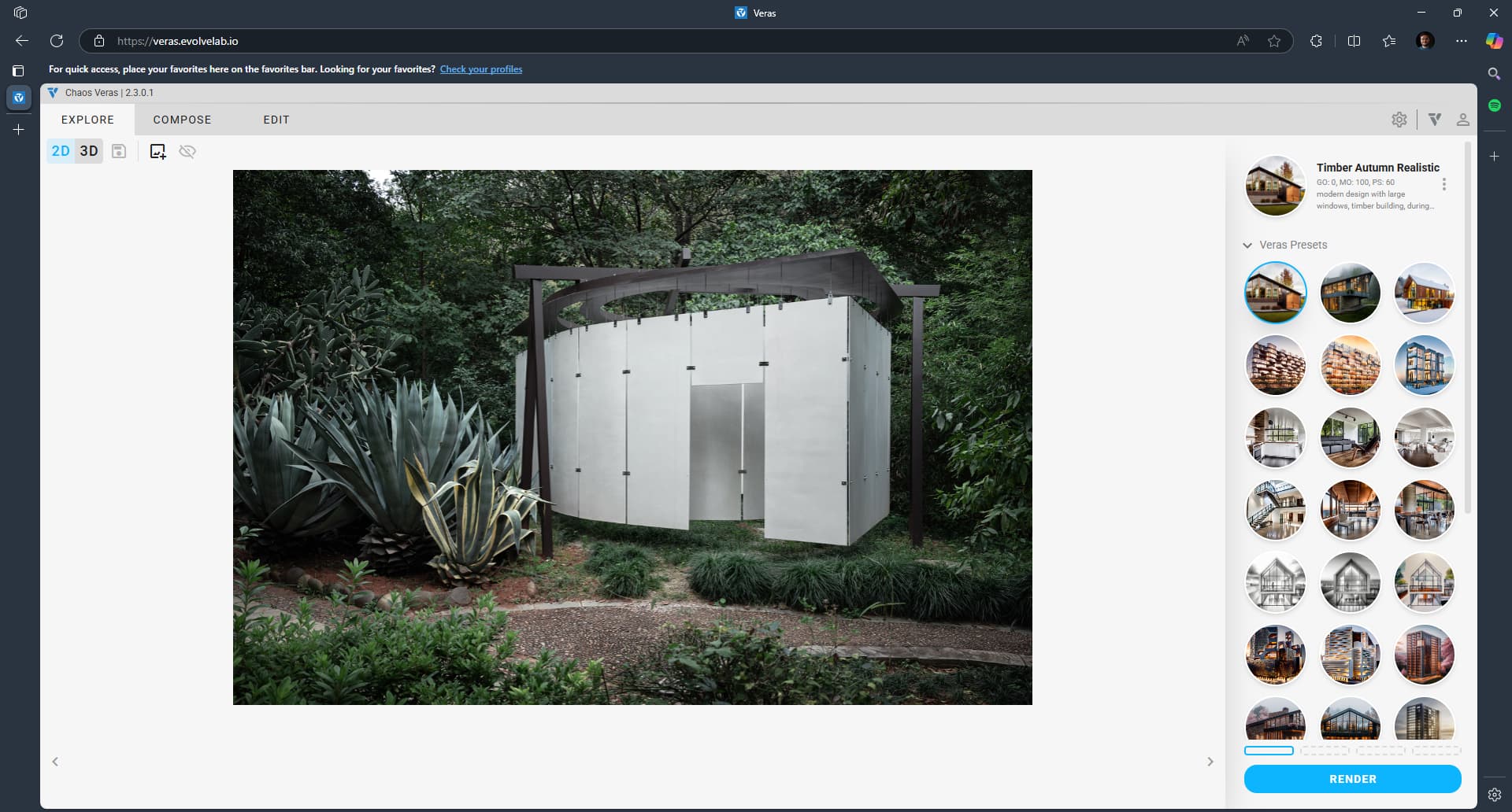

I was experimenting with the new update and the drag and drop image feature.

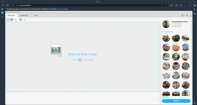

When I drag on images they do show up as the 3 images being dragged on but when I drop it only one of the images show up.
This feature only works with renderings generated by Veras version 2.2 and up.
To clarify a bit further, this is the specific feature @verma is referring to:
Right now, Veras can only have one ‘preview’ image at a time, which can be any image that was not generated from Veras. If you drag-and-drop multiple ‘preview’ images, only one of them will show up.
However, if you have images that were generated by Veras, you can upload multiple of these at once. They will show up in the bottom gallery, and each will have all of the settings that were used to generate it populated in the panel on the right.
I hope this helps to clear this up. I understand how with what we posted and added with this feature, and what you expected, it may have been confusing. We’ll try to brainstorm some better ideas to handle multiple preview images at a time - but please feel free to share any suggestions you may have!
