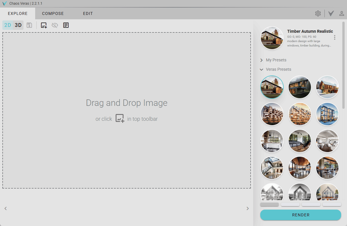

Load Render Settings From Saved File
Veras now embeds render settings directly into your image files! Simply drag & drop or upload any Veras-created image, and all settings used to generate that image will automatically populate in the compose or edit tabs.
2025-05-19 - 03-56-03 - chrome
We have also simplified the file naming, as the previously long names containing the first 100 characters of the prompt were sometimes causing issues. Now, it’s in the date and time, followed by the name of the preset used, if a save preset was used.
Example: 2025-05-20 12-23-34 - Timber Autumn Realistic.jpeg
This means you can close and re-open Veras, in for the most part continue working from one of your previous images!
For the technically curious, the settings are stored in the ‘comments’ exif property of the image file, which you can now see when inspecting the properties of any Veras-generated image.

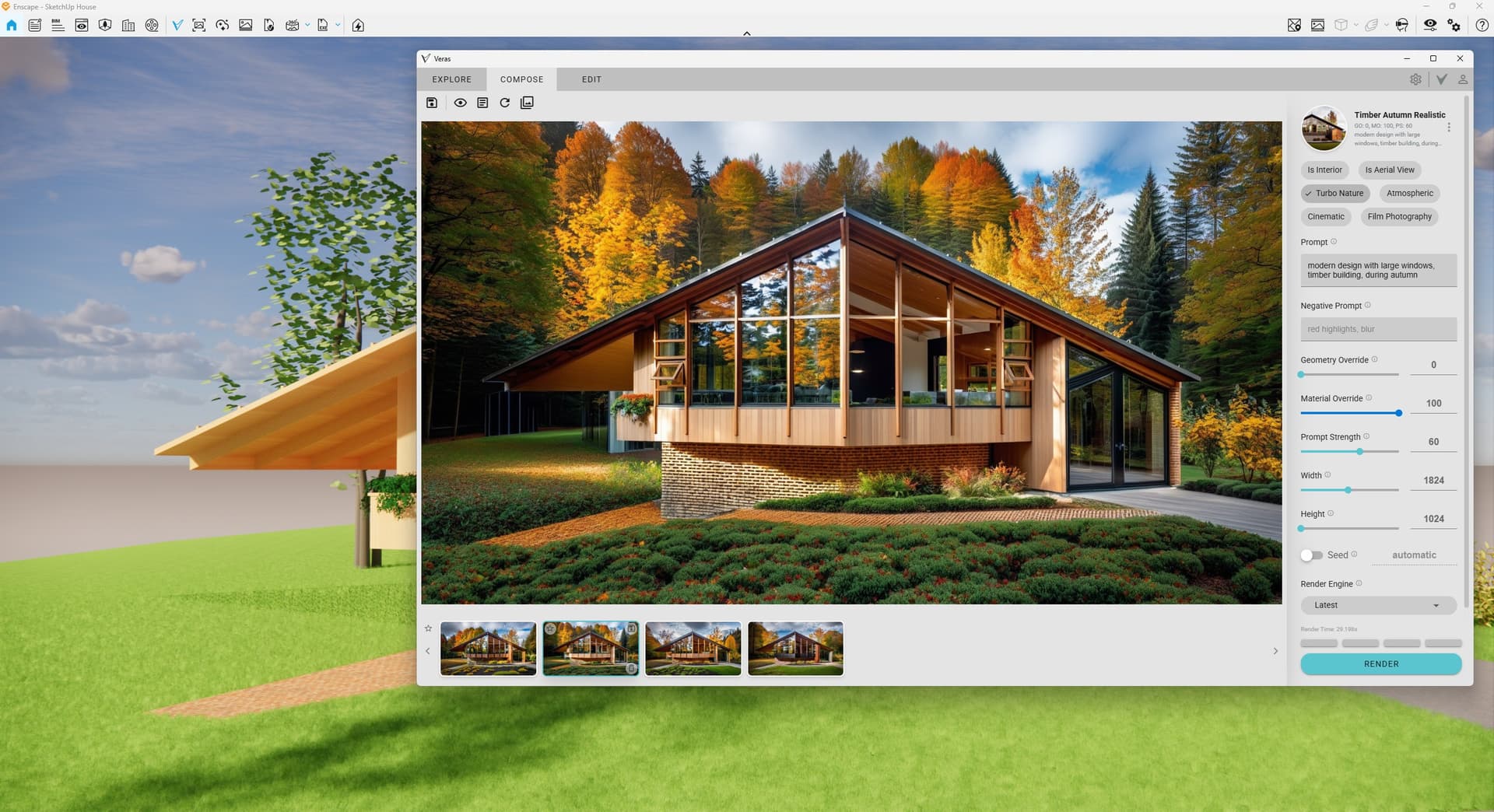

  • Aspect ratio now automatically resets to 16:9 when uploading a 3D model, unless a 2D image is already present.
  • When using the Veras SDK, we’ve added the ability to send the Veras rendering image back to the host client.
  • Improved Enscape integration, including how users are auto-logged to Veras inside Enscape, and what data is shared between Enscape and Veras.
