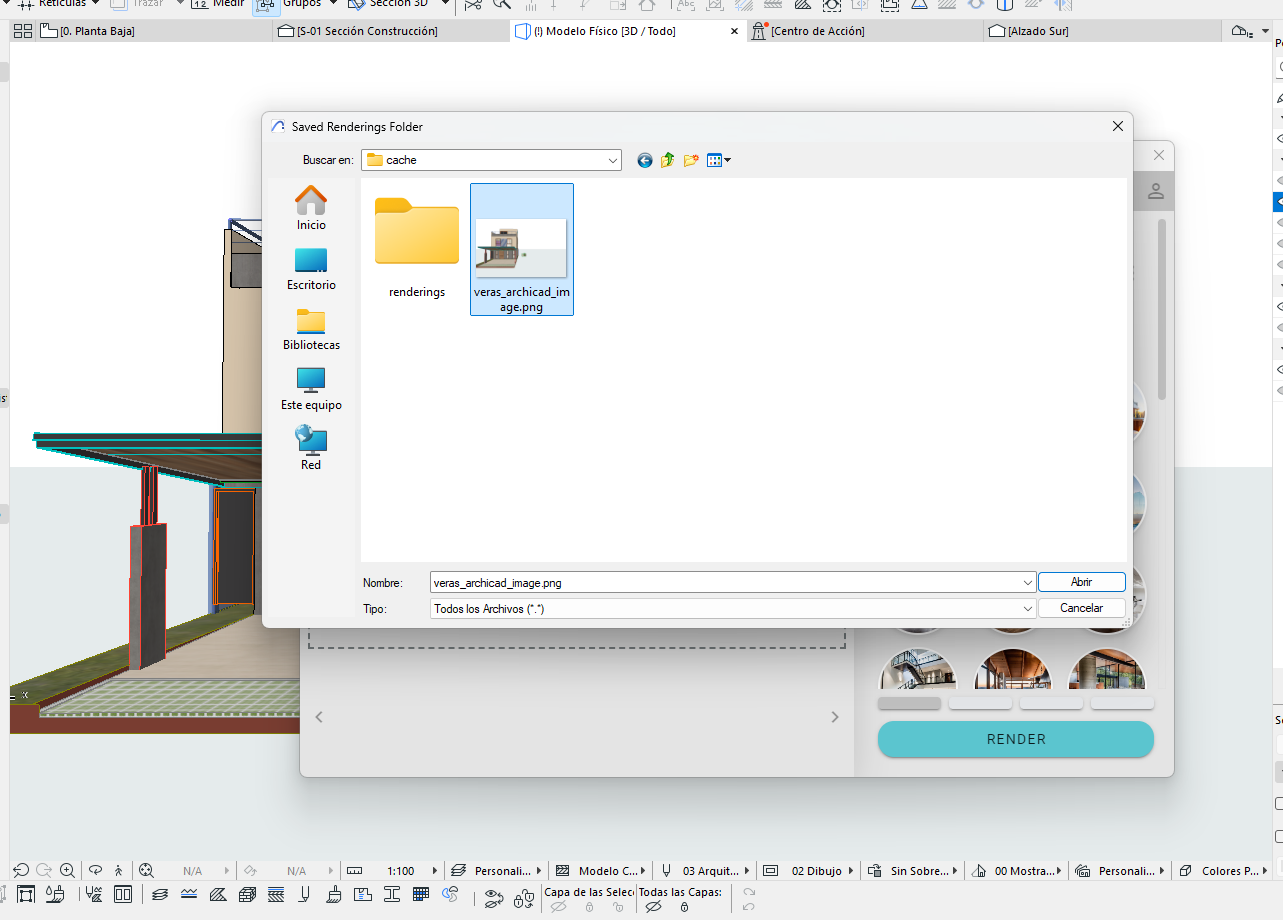

We also have the same problem. The difference is that the error number is 294. There is a “veras_archicad_image.png” file in the cash folder, but it doesn’t go any further, even if I ran archicad as an administrator.
Could you possibly help with some solution suggestions?
thank you in advance
I may be able to help you with a little more information. Firstly, knowing that veras_archicad_image.png exists is a good first step–thanks for that. Next, I’d like to know if you’re able to manually open that image file, and view the image as expected.
A couple other questions that occurred to me:
  • Are you on Windows or MacOSX?
  • Are there somehow any special characters in the path to the aforementioned image, such as in the user profile name?
Despite your attempt to run with admin privileges, I think it’s still most likely a read privilege, based on the error you’re seeing. It’s not totally clear to me whether Oleksii’s earlier post is stating what they’ve tried, or what worked for them, but I believe that’s a good approach to take. By going to Properties->Security tab you can ensure the read and execute privileges:
And antivirus/security software is definitely something else to look at. You may have to add that image file to a whitelist–better yet, the parent cache folder, if this ends up being the case.

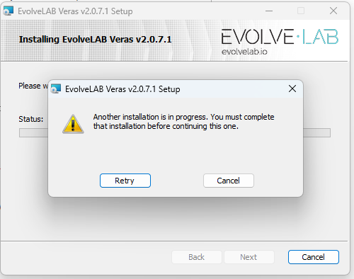

Give this installer a try, please. (Testing the fix for Windows only, for the moment.)
Veras test installer
When I try to install it after accepting the terms and conditions and then install it, I get this screen and it does not move forward no matter how many times I press Retry.
I kept trying and it allowed me to install it, now it works perfectly.
