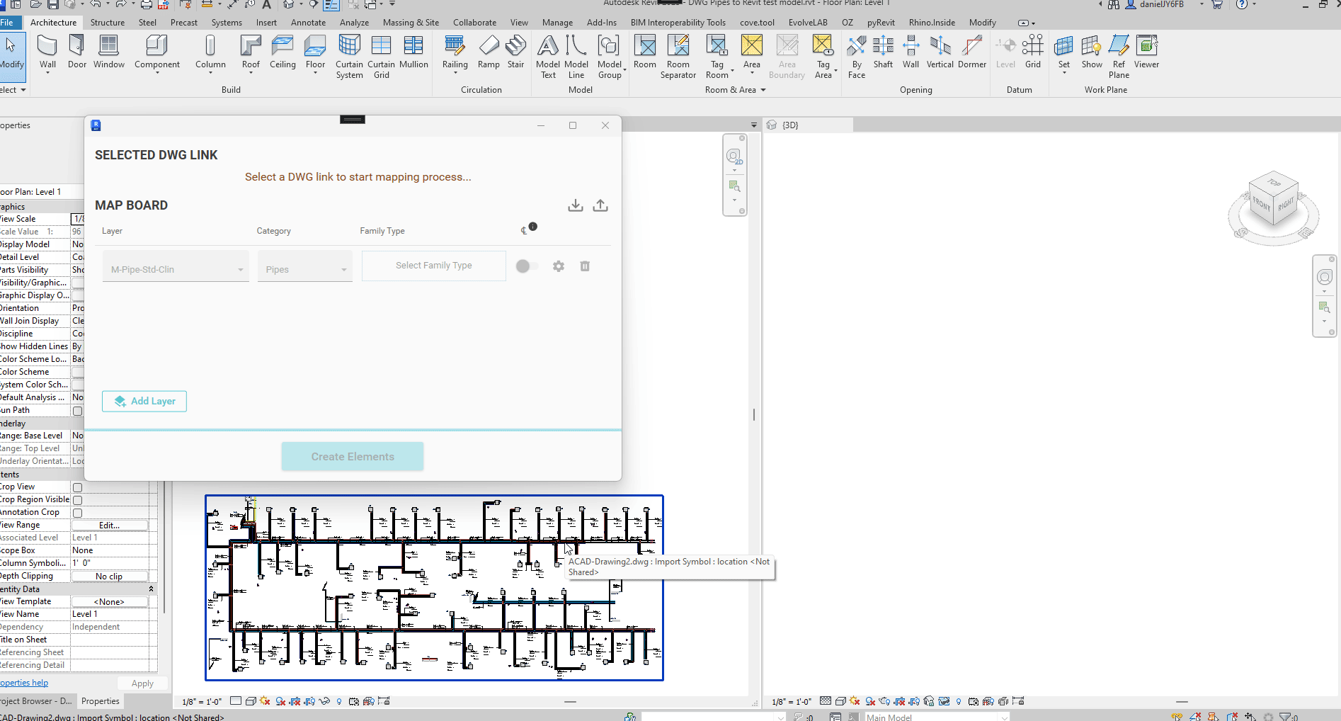

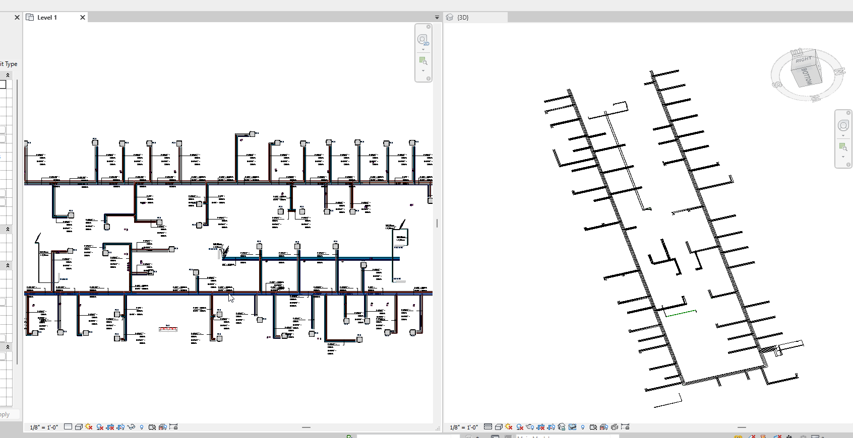

Here are two gifs, the first is a 2+ minute gif of me using the updated Helix code on the “M-Pipe-Std-Clin” layer of the sample .dwg file you shared with us. The second is of the CAD files and pipes in Revit after the process is finished. All in all, Helix converted about 2,700 lines into 786 Revit pipes in just over 2 minutes.
