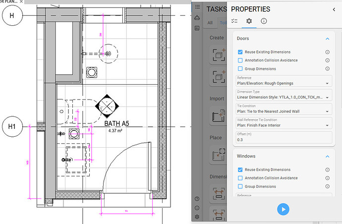

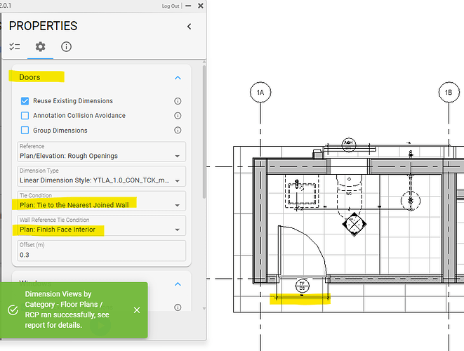

Hi Miguel ,
We are facing this issue :
Under Dimension Views by Category
Re : Unable to tie dimension setting of the the door to nearest joined wall
My machine config: Revit 2025, Glyph 3.2.0.1
@massrazz, thank you for letting us know about this. Did you get any error messages in the status report?
I just tested it myself, and it worked as expected.
Revit_WdEiF6QAbs

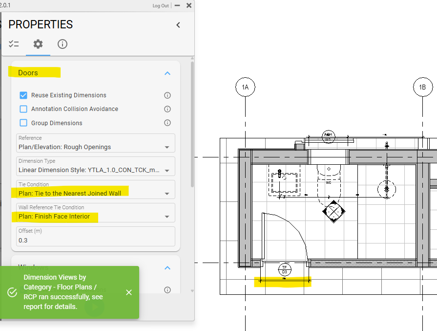

Hi Miguel
Thanks for your reply.

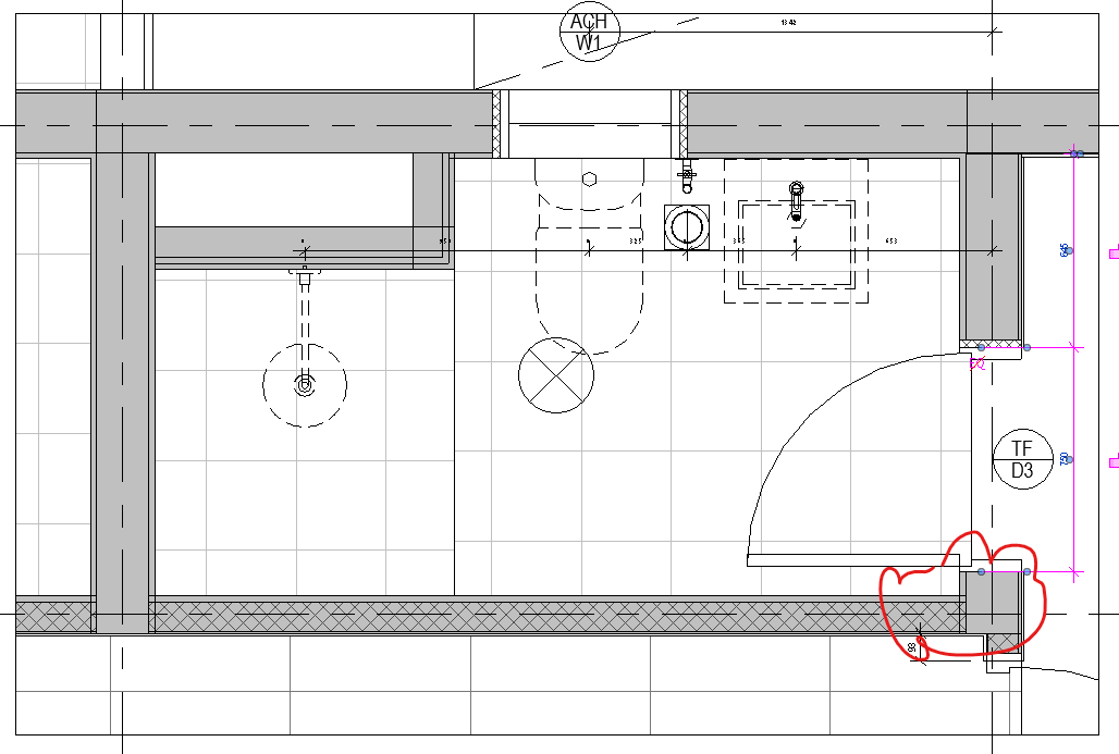

It works now (see below), thankfully. however, how does glyph detect the nearest wall for it to pick up the dimensioned to be tied to ? in the image below, the nearest joined wall should be the one as clouded :
My machine config: Revit 2025, Glpyh 3.2.0.1

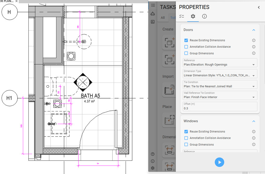

Hi Miguel,
This is a follow up on my post above where the door dimension managed to tie with the nearest wall.
In another occasions when we run the task of the same setting , like the image below, it doesnt work. Anything i’ve missed out?
My machine config : Revit 2025 Glyph 3.2.0.1

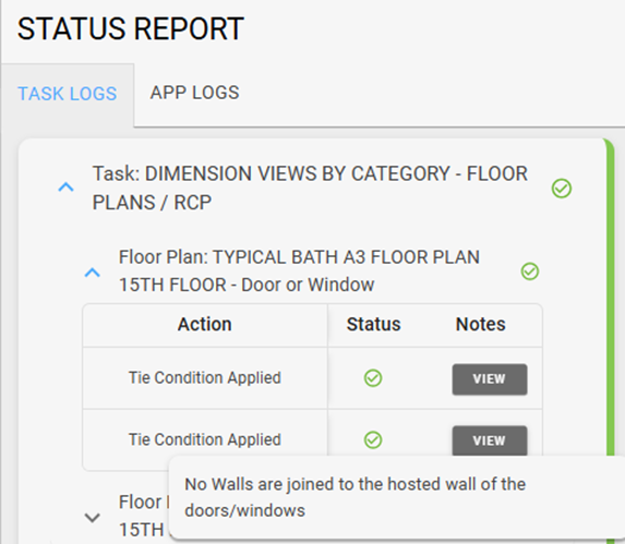

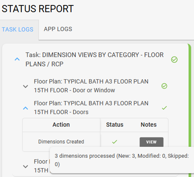

@massrazz, can you send a screenshot of the status report log whenever you see the message, “See report for details”?

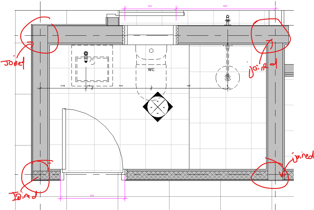

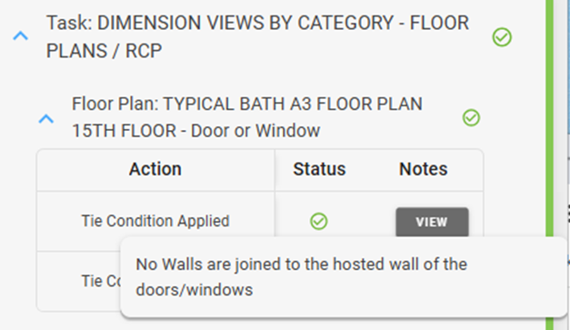

Hi Miguel,
Re: to my post above on the 27/2/2026.
Here it is the details of the report :
It says here no joined wall, but all the corners in the image below are joined:
I will include the report details screenshot alongside my queries in the future.
My machine config : Revit 2025, Glyph 3.2.0.1
Hi Miguel , any update on my query as above ?
Hi @massrazz, We added this bug to our roadmap and it will be fixed in future releases.
