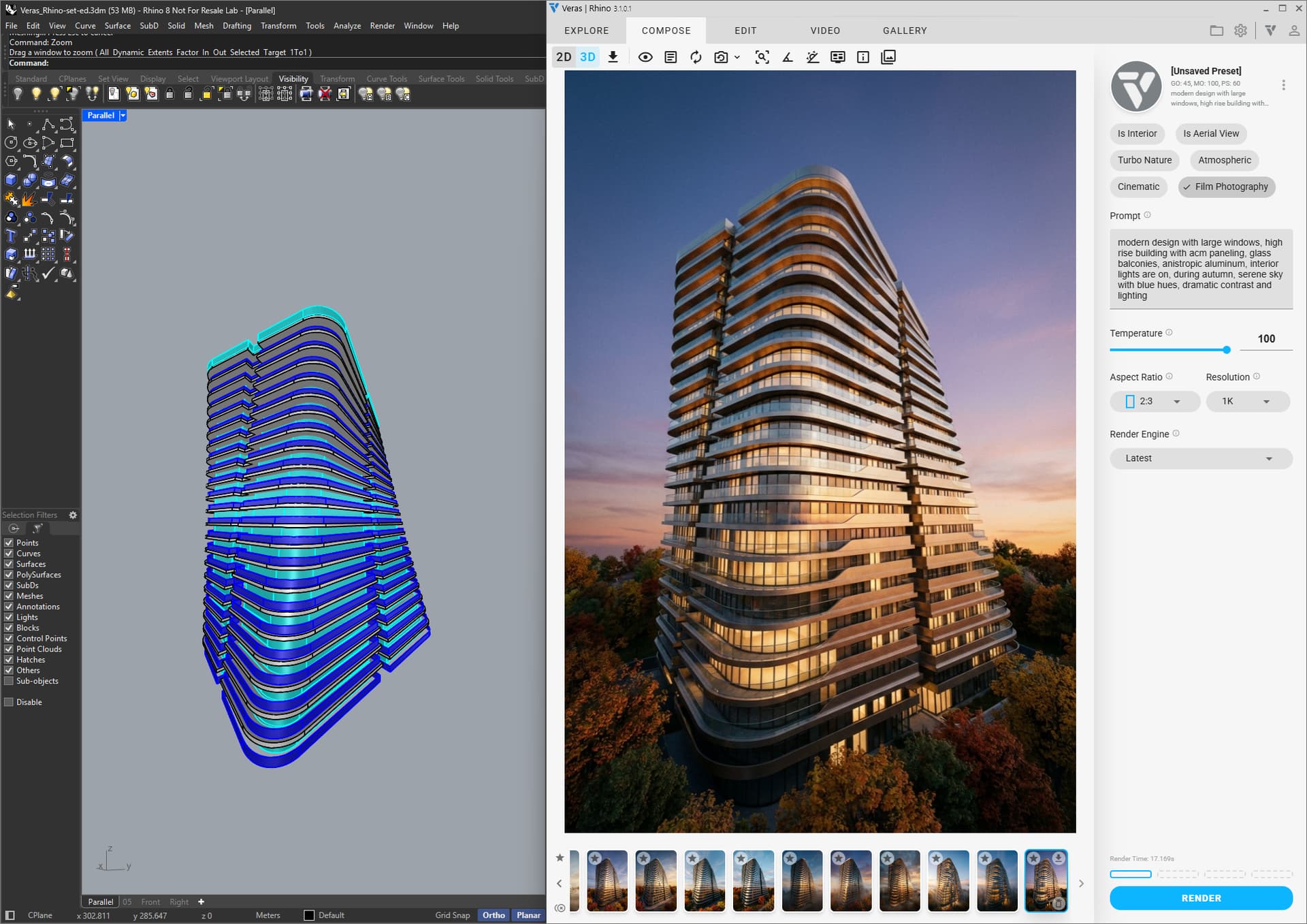

I ran some quick tests, and it seems like the word “skyscraper” tends to make the results more distorted. Changing the prompt helped.
These are preliminary results, and they need more refinement. We’re working on V2 of Veras that will add better control. I’ll post more examples here as we improve this more.
Here’s a higher resolution version to see the details (there’s plenty of room for us to improve here):
And some close up shots:

Veras V2 is officially released!!
Here’s the release post:
I ran some more tests using this model: Veras - Release 2.0 - 3D Mode!
The new version of Veras is taking this to the next level!!
