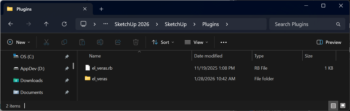

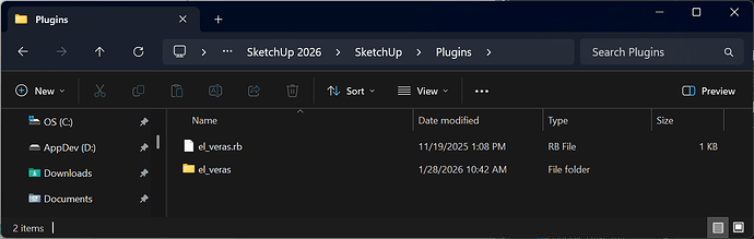

We will be adding support in the installer next build. For now, as a work around it just requires you to copy the file/folder into the 2026 specific Plugins folder.
If you look in this folder for 2025 you can grab it.
%ProgramData%\SketchUp\SketchUp 2025\SketchUp\Plugins
You will find the Veras plugin.
el_veras.rb file & el_veras folder
you want to copy both over to the 2026 folder
%ProgramData%\SketchUp\SketchUp 2026\SketchUp\Plugins
It will look like this
Sorry for the hassle, will make it easy next installer we release.
