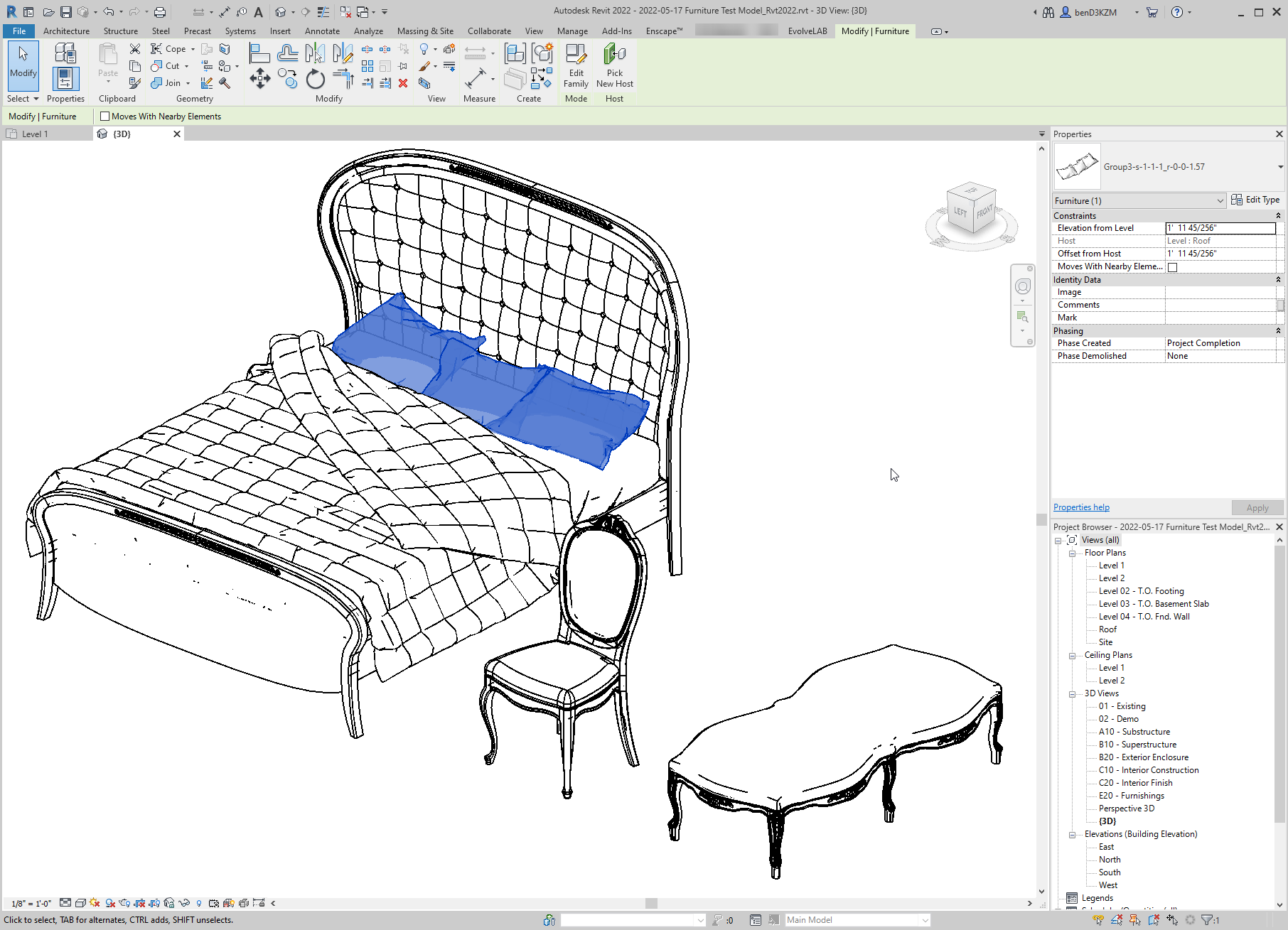

I went ahead and converted the SketchUp Warehouse components that you shared using the DXF mesh based mapping. This kind of mapping creates Revit families that are not parametric: families just host the mesh data statically. I used Enscape to render the families. I’ve also update the download link to include these sample files.
See images below with my results.
Workflow notes
  1. mapped each group as a family per their material
    :bulb: we can further automate this process if it is important to your workflow
  2. send the mapped content to Revit from SketchUp
  3. set the materials in Revit using the imports in family tab under object styles
