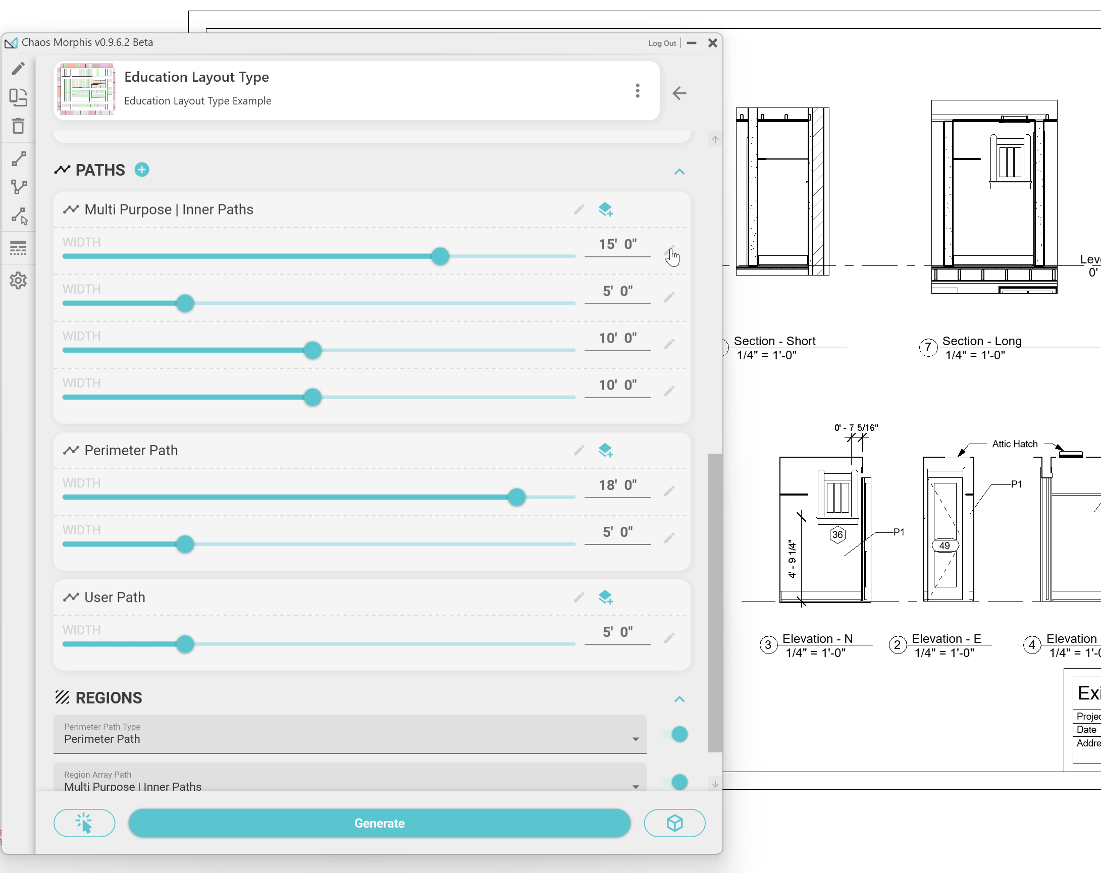

My guess is that you have to add each module type to the path types you are using. Even if you have the module in a specific layout, you’ll need to edit each path type and make sure all modules you want to be arrayed on that path are selected:
RevitZMaCRjFGMg
I am not sure why modules are only generated on a perimeter or inner array, but not both. As long as you have set perimeter and inner paths, and you have modules enabled on both path types, and you spaces is big enough to fit both of course, they should both get created at the same time. I could be misunderstanding. Can you share an image or gif of this? That would help narrow it down.
