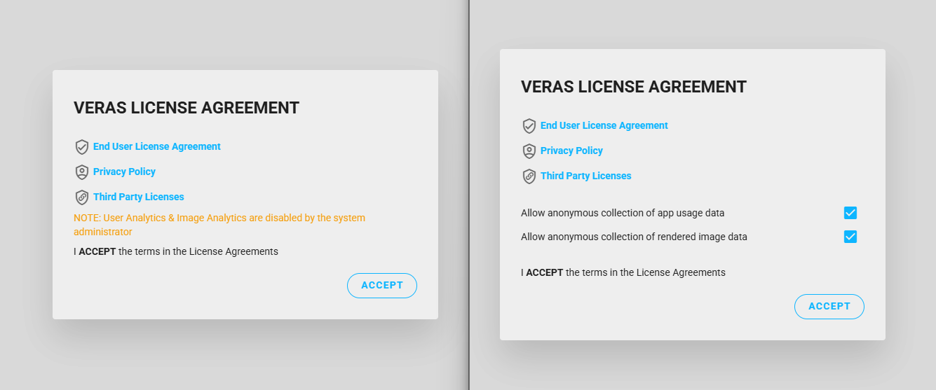

No Analytics Flag
Some entities would like to disable the default option for analytics.
Using a deployment software (ex: PDQ Deploy), admins can add the DISABLEANALYTICS=TRUE property.
Here’s an example of a silent install with this property using command line:
msiexec /I EvolveLAB_Veras_Setup.msi DISABLEANALYTICS=TRUE /quiet
Running this should create the proper registry keys and values in this location:
HKEY_LOCAL_MACHINE\SOFTWARE\EvolveLAB\Veras
When users first open the app they will see the image on the left, instead of the default options.
