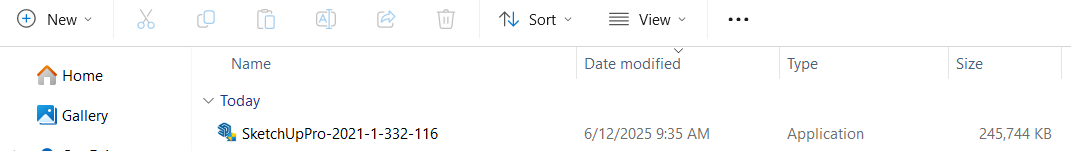

@chanarch I found this forum thread where someone shares a link to an existing download: Where I can find SketchUp 2021 PRO for download? - Pro - SketchUp Community
They have a link for a download, so I downloaded the installer, and the version does appear to be 2021.1.332
