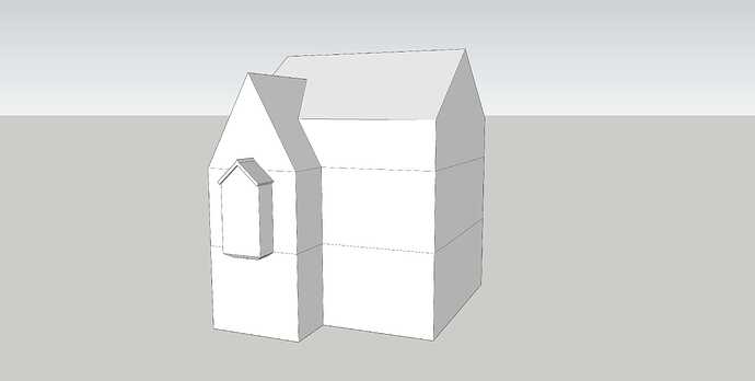

Articulation usually means a primary mass, a secondary mass, and a set of details. The primary mass in the example building shown, is the larger part of the house with dormers and chimneys and a roof ridge running parallel to the street. The secondary smaller narrower mass protrudes outward from this primary mass and its roof ridge line runs perpendicular to the street. Windows and doors play the role of details - windows which perhaps even protrude as bay windows.
