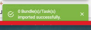

I created a dozen or so tasks and bundles, exported them out to a folder on my PC, renamed them, and moved them to a shared folder location for testing. Now, when I try to load in to a new project, the UI gives an message saying that 0 bundles/tasks were loaded successfully.
In some instances I noticed that even when I get the message that zero have been loaded in, I notice that some tasks/bundles have still been loaded in. I have tested this several time and sometimes it loads in some of the tasks, sometimes none of them.
Are you aware of a bug preventing tasks to be loaded in? Is it likely due to the fact that I both renamed and relocated the tasks?

After doing a little testing with this setup I have a little more insight into what I think is happening. When I import a task or a bundle by dragging from the shared network drive and immediately click ā€˜import’ in the Glyph UI, I almost always received the zero tasks/bundles imported error previously mentioned.
If I wait a few seconds before pressing ā€˜import’ - after dragging in the desired tasks/bundles from the network drive - then Glyph will successfully import them. I generally did not have to do this when importing the tasks/bundles from my local hard drive because the read and write speeds are faster than our network drive - but in the rare instances where I did experience issues waiting a few seconds before pressing ā€˜import’ resolved them.
