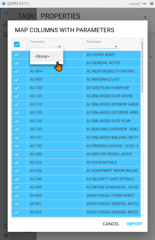

Hello Miguel,
I have the latest version, but for some reason I am unable to map the parameter to any of the columns in my excel file. I tried with my own file and the custom template you can download
Hi @Sterling,
You need to have at least one sheet in your Revit model. Could you create a new sheet and try again?

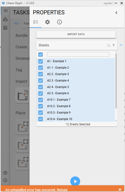

Hi Miguel,
The Task logs list is empty, and i do get this notification - at the bottom in orange:

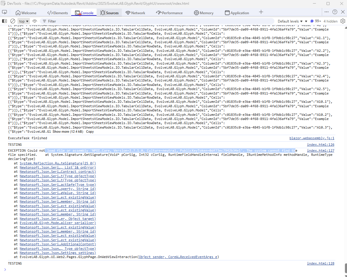

Hi Miguel,
This is what i see in the window :
Thank you for providing the screenshot. We have fixed this bug, and the fix will be included in Monday’s release of Glyph 3.2.

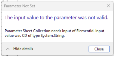

However, one of the parameter what we want to use (Sheet Collection native Revit parameter) could not be used.. When we map Sheet Collection parameter to one of the column - we received an error as this:
We have tried to assign the Sheet Collection parameter to different columns in the excel and tried changing the name as well, still doesnt work..
I also have created the respective Sheet Collection in the project browser first, before running the task - but still receiving the same prompt as above..
Appreciate your advise
Hi @massrazz,
Thank you for letting us know about this bug. We will fix it and include the fix in the upcoming release.
