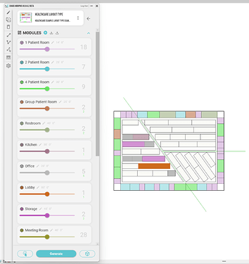

Morphis is a very configurable tool. It’s broken up into some primary components. Modules, Paths, and Regions.
Modules represent the space an object or room takes. They can be configured with width, specific wall types, rooms, model groups or families. You can also determine if there is a range of these modules or a fixed number.
There are two Regions, the “Perimeter” or the “Region Array” which is the space inside the perimeter.

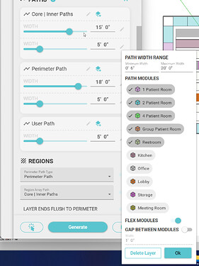

Paths are the layers of Modules, here we can define what Modules will display along this path, the depth, and some control of how the Modules behave like adding a gap between each Modules or if the modules flex in size to fill space. Users can setup as many paths as they like and can assign two of those types to the Perimeter or Region Array path.
The Healthcare type preconfigured with number of different modules.
Each path can be configured to include any or all of the modules.
It’s not really a blind automatic tool, it’s just very configurable. The logic is determined through configuration. Kind of a hard tool to describe in words, happy to give you a quick demo if you are interested.
