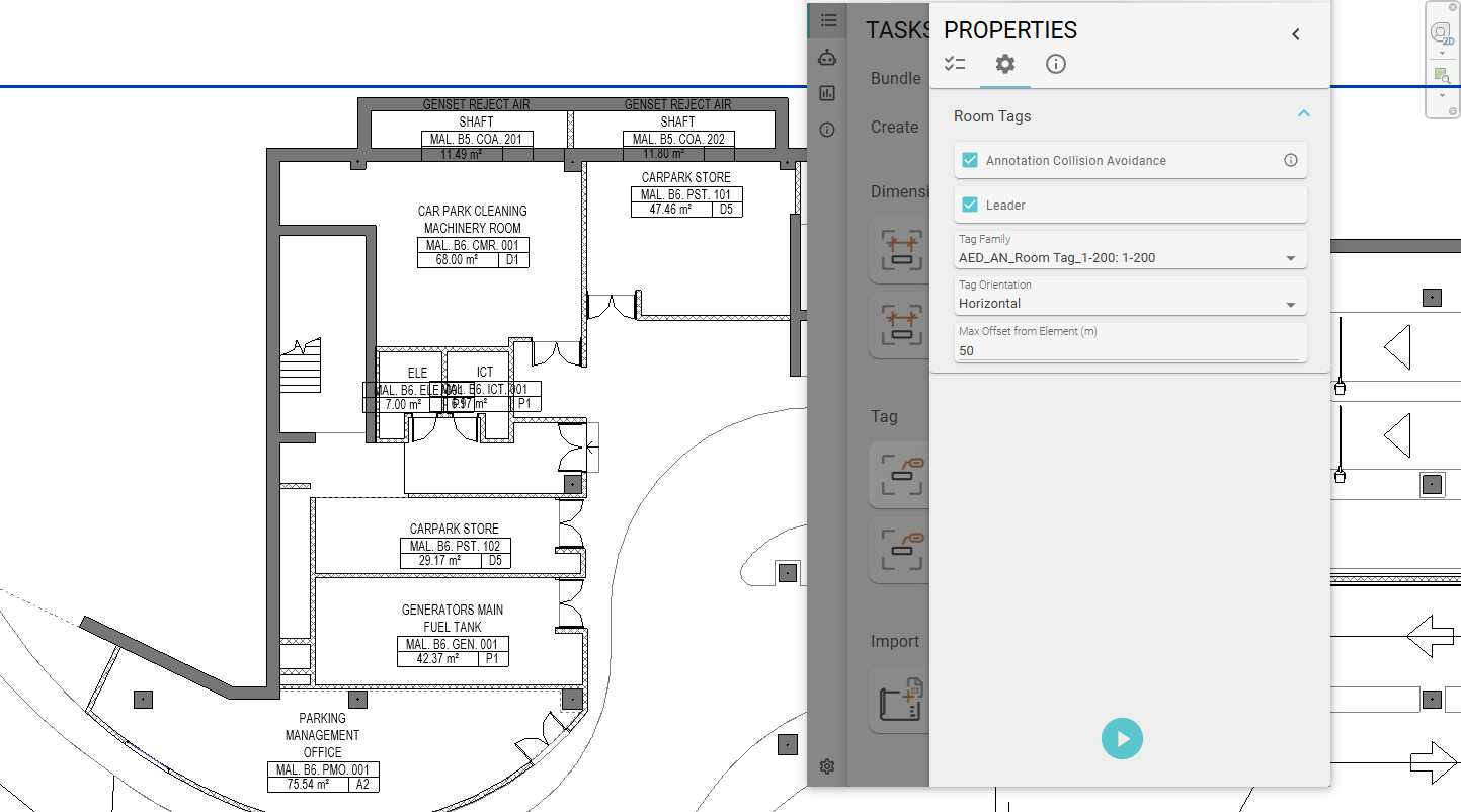

thank you. can i ask further question about room tag, the room tag is overlap with geometry or other tags? maybe the setting we did is wrong.

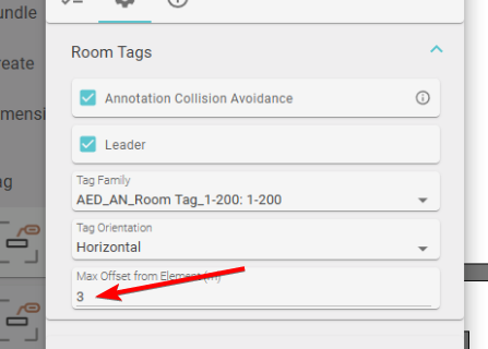

Hi @sindytsang,
It looks like your room tag is quite large. I recommend increasing the following number to test more possible empty spaces.

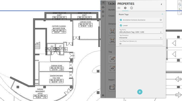

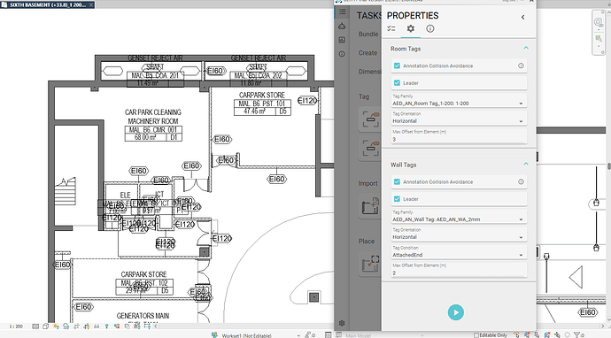

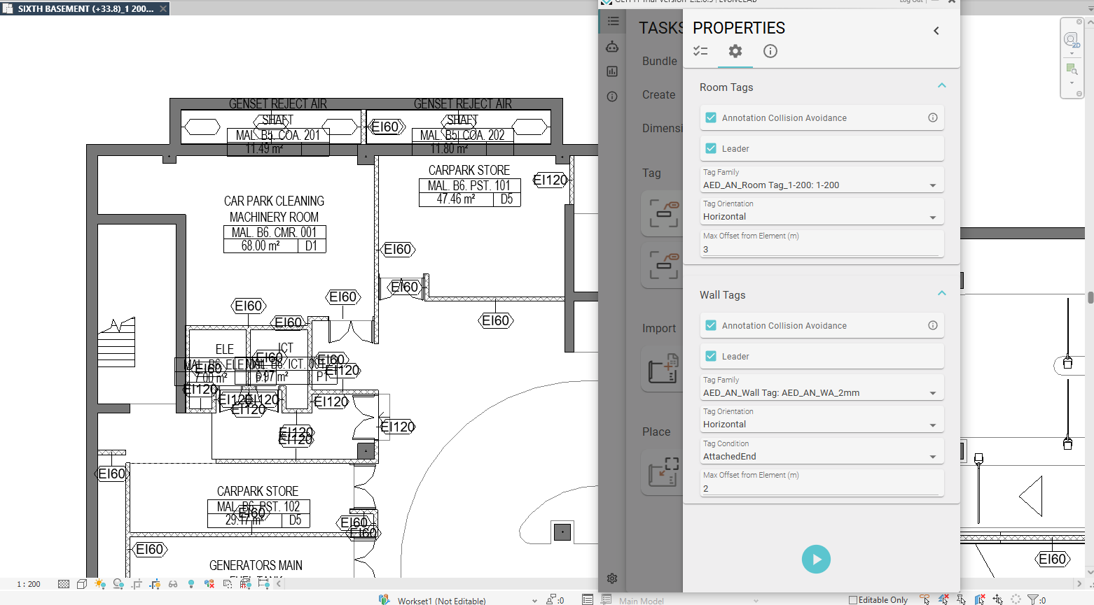

thanks for the answer, sorry forgot to mentioned we work with linked model, not sure will that cause the issue? i have change the offset, but it stay same location, please see the snip below, thank you
Hi @sindytsang,
Working with linked models shouldn’t cause any issues, but in the layout you sent, I noticed some tiny rooms that are smaller than the room tag. In this case, Glyph wouldn’t be able to find an empty space, so it will place the tag in the best-fitting location.
