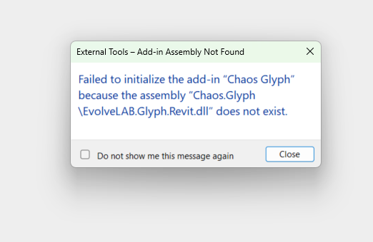

Hello! I have just downloaded glyph, and can see the application in Revit 2026 but not Revit 2024 (which is the version I am hoping to work in).
When I open Revit 2024, the following message is shown. Do you know a solution to this?

Hi Emily,
Which version of Glyph are you using? We released Glyph 3.4.0.3 yesterday, which should have fixed that issue.
Thank you,
Thank you so much! Yes that has fixed it.
I am glad that it’s fixed. Thank you for raising this bug!
