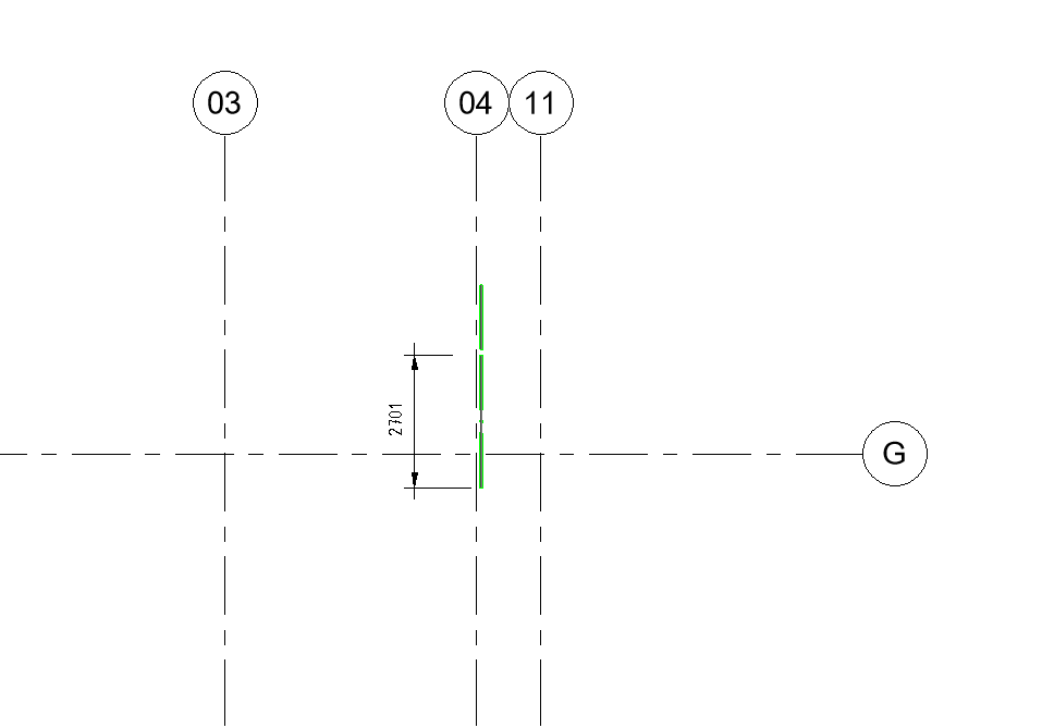

I am trying to dimension all pipes in a plan view, but the tool only picks up vertical pipes. What could I be doing wrong ?

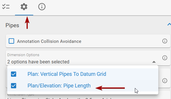

Hi @MJAIMAN2024, great question! You can dimension horizontal pipes in plan view by checking the following settings:

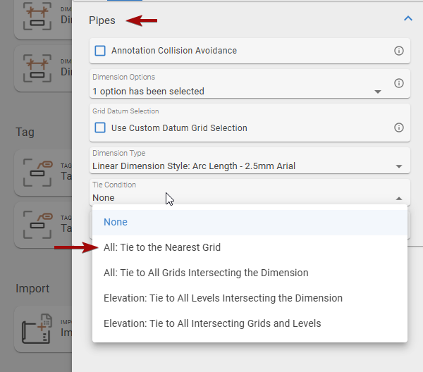

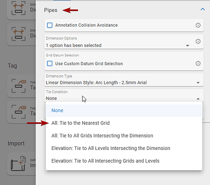

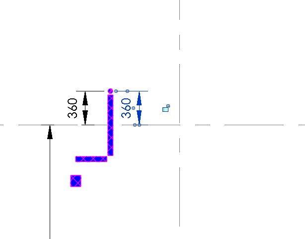

Thanks Miguel, is there also a way to dimension the pipe location to gridline. Currently , I am only able to dimension the pipe length.
@MJAIMAN2024, You can associate the dimension with the nearest grid by enabling the following option:
