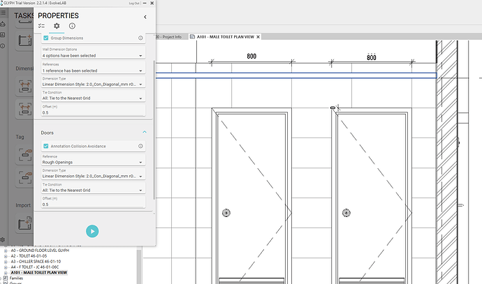

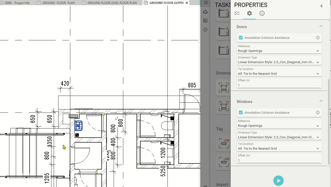

Dimension view by category: We are currently facing issue with dimension overlapping and missing wall reference dimension for doors.
Welcome to the forums!
I believe that much of your overlap issue is related to the 1m offset. For those interior walls it is causing the dimension to interfere with the dimensions on the other side of the hall.

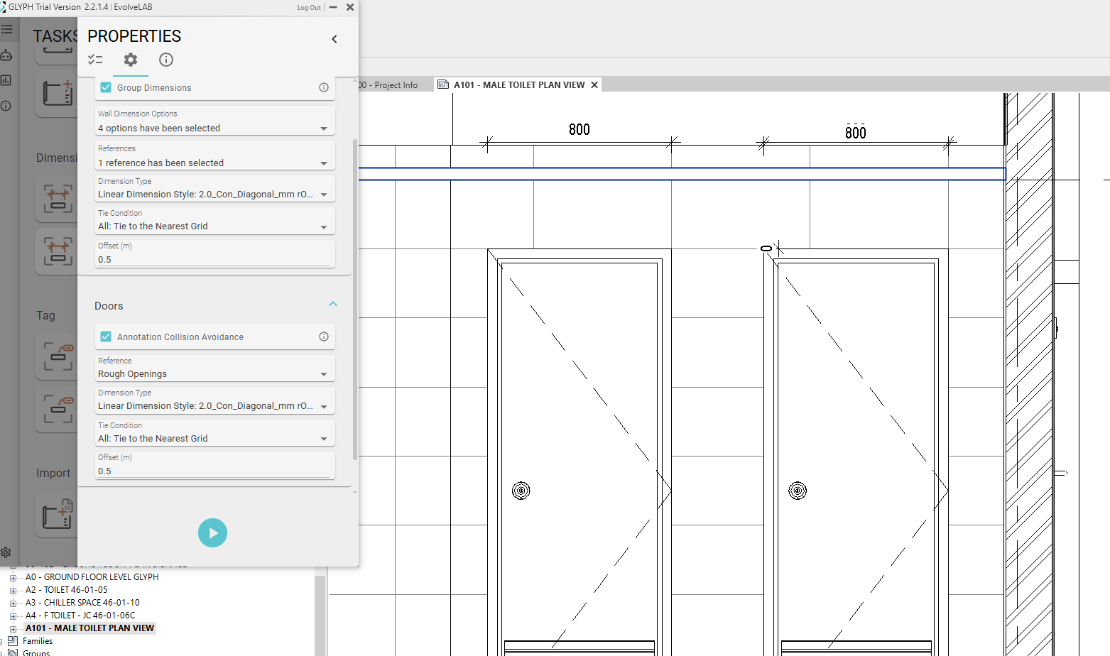

Could you export the task that you are working on so I can look at the configuration. I want to try to replicate the missing wall reference dimension issue.
Glyph Tasks.glyph (38.4 KB)
I believe this attachment provides enough clarification. Please resolve the issue as soon as possible.
