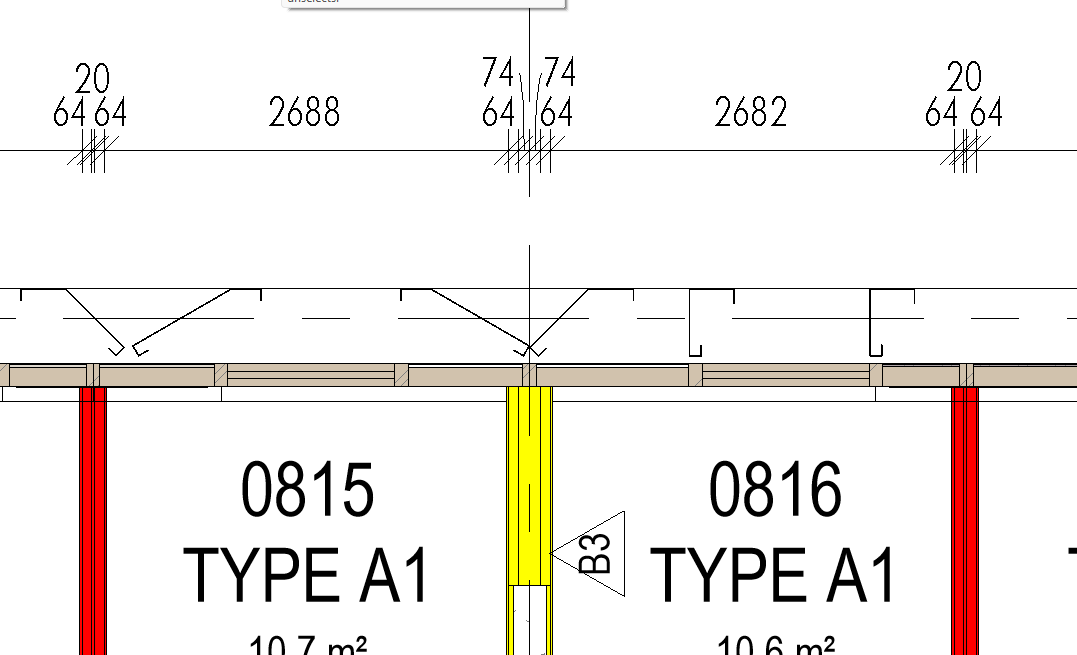

Is it possible to dimension to core layers of a wall using glyph? Ie dimension a double stud layout (with an air gap inbetween) partition walls where both studs need to be dim’ed for setout?
Hi @Flicks_FC, great question! It depends on how the wall type is built in Revit. Glyph can dimension the core layers of a wall, but it currently only supports either the core exterior or **core interior—not both.
In your case, since the wall has multiple stud layers, Glyph won’t dimension both the core exteriors or interiors of each stud layer. That said, I’ve added this to our backlog to ensure we support this in the future.
