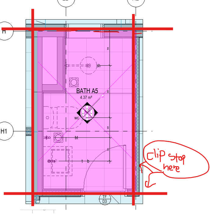

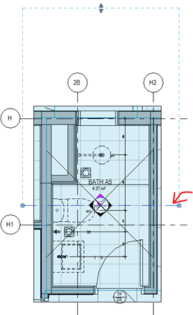

When we create multiple floor plan views, we have to manually adjust the Far Clip Offset for each of those floor plans..:

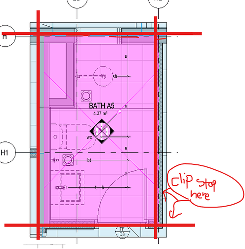

Is there a way to adjust the Far Clip Offset to stop at the room boundary line? :
This will help when we are doing the tagging ; as all the items within the far clip offset region in the section views will be tagged..
Appreciate your advise
