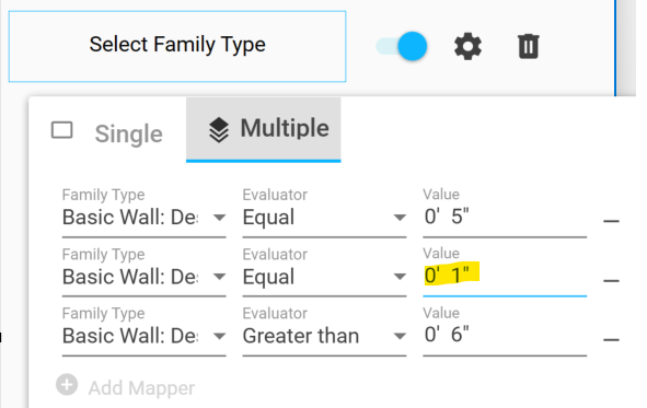

Here’s my setup. I think I had a duplicate wall originally. Would that have caused an issue?

Regarding your question about duplicating the layer. Yes, that will cause an issue. You should instead use the Multiple option inside of Select Family Type to define 2 types on the same layer.

How to do input 0’ 4 7/8” in the Value? There are several wall thicknesses in this project, so it is easier to put the Equal value there. Entering values has been tedious for many of them. Just adding 0’ 6” can be difficult.
