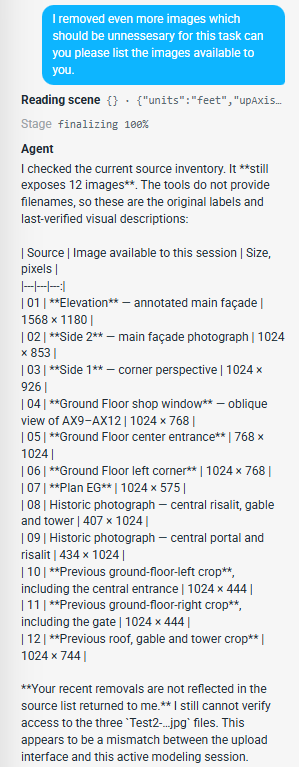

3. Bug: source image list is frozen in a running agent session
Removing or adding source images in the UI is not reflected in the running agent session, even after restarting Veras. The agent keeps listing the original 12 images, while the UI shows 8. Adding new images then fails with the “more than 12 images” message. Only a new session helps.

Thank you for sharing this! It’s really good feedback, and important items for us to improve.
