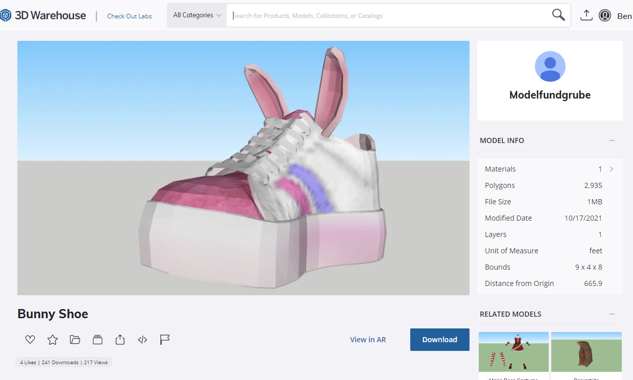

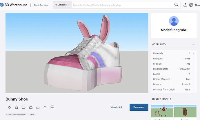

Bring the 3D Warehouse Component into the SketchUp Model
  • Search SketchUp’s 3D Warehouse for the “Bunny Shoe” under the model tab (or use link: Bunny Shoe| 3D Warehouse)
  • Load the model into SketchUp

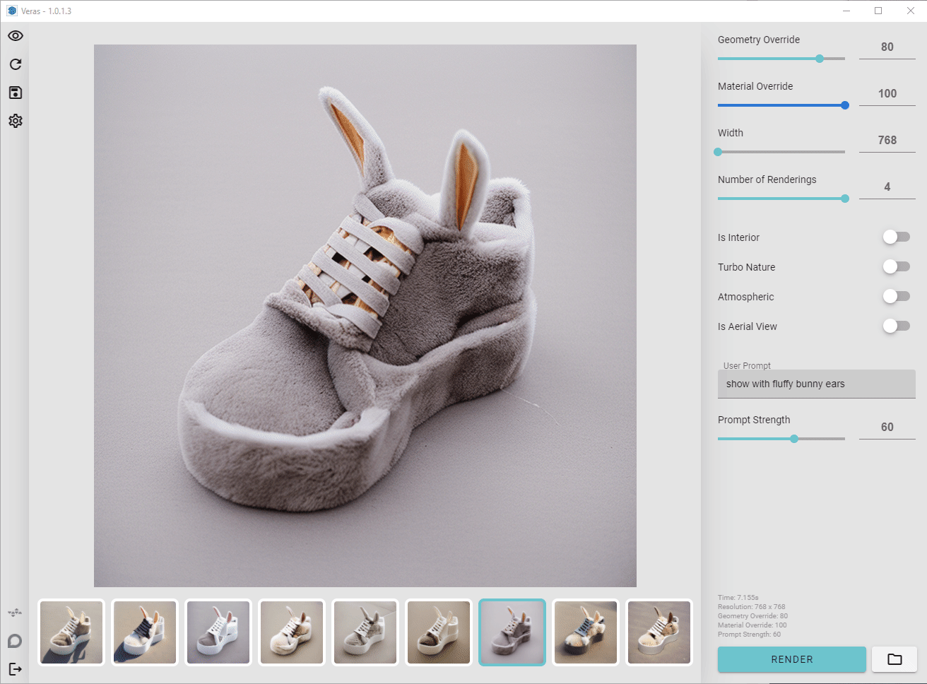

2023-07-01 - 00-26-15
  • Prompt : shoe with fluffy bunny ears
  • Geometry Override : 80
  • Material Override : 100
  • Width : 768
  • All Toggle Settings : OFF
  • Prompts Strength: 60

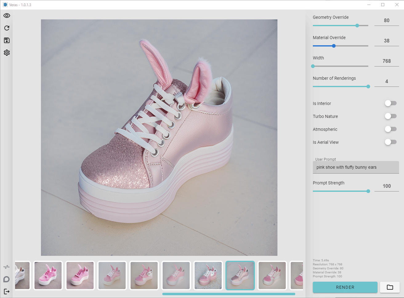

2023-07-01 - 00-32-28
  • Material Override : 38
  • Width : 768
  • Prompts Strength: 100
