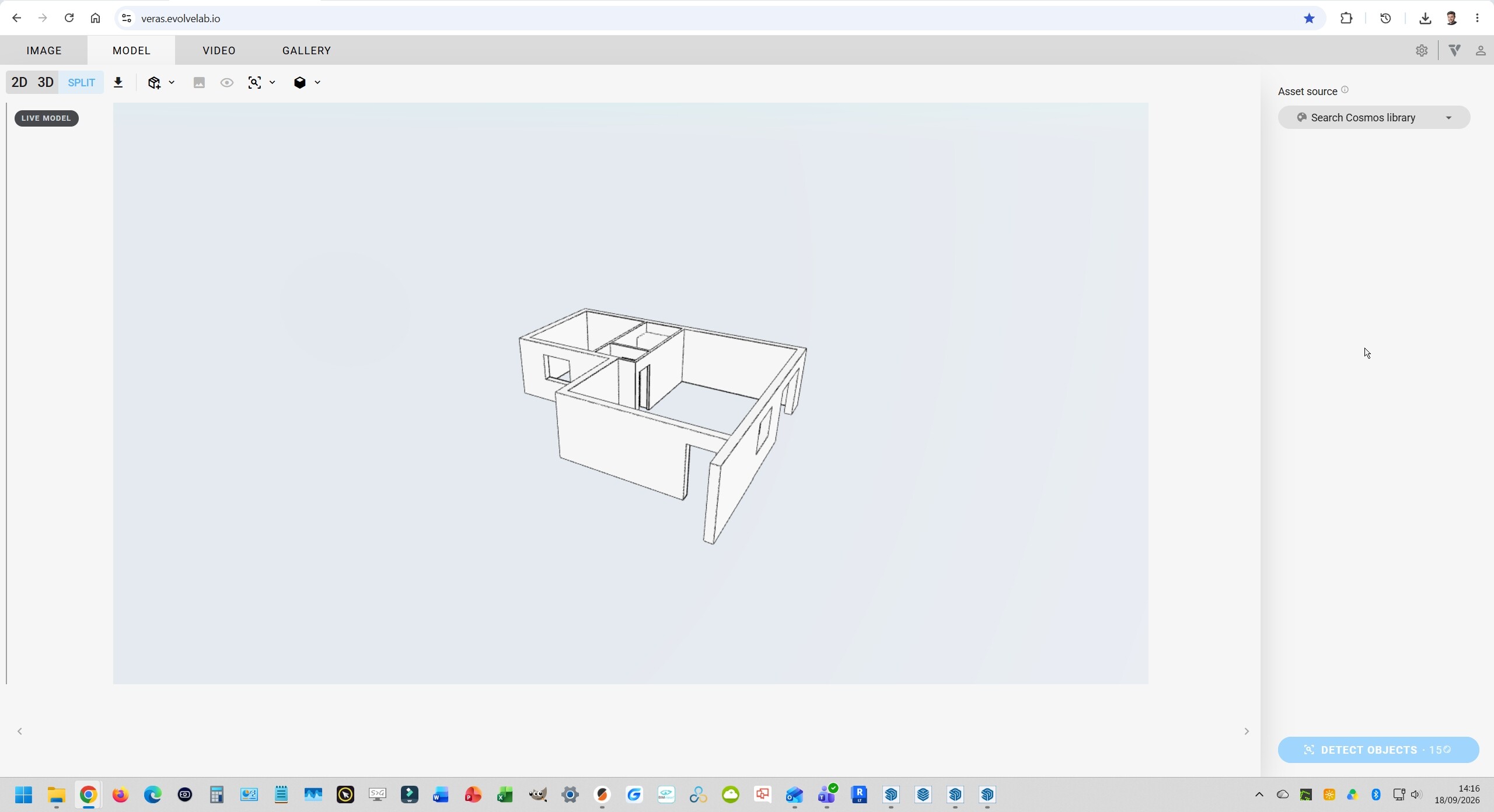

  1. In the “Image” section, I upload an .obj file exported from SketchUp.
  2. I get an error (“Loading materials completed with errors”).
  3. The model appears, but I can’t navigate around it.
  4. So, I switch to the “Model” section.
  5. There are 2D (why here too?), 3D, and split tabs again, but there are no buttons on the right to do anything… What is the “Model” section for? Sorry if this seems like a stupid question, but I haven’t found any information about it online. Thanks.

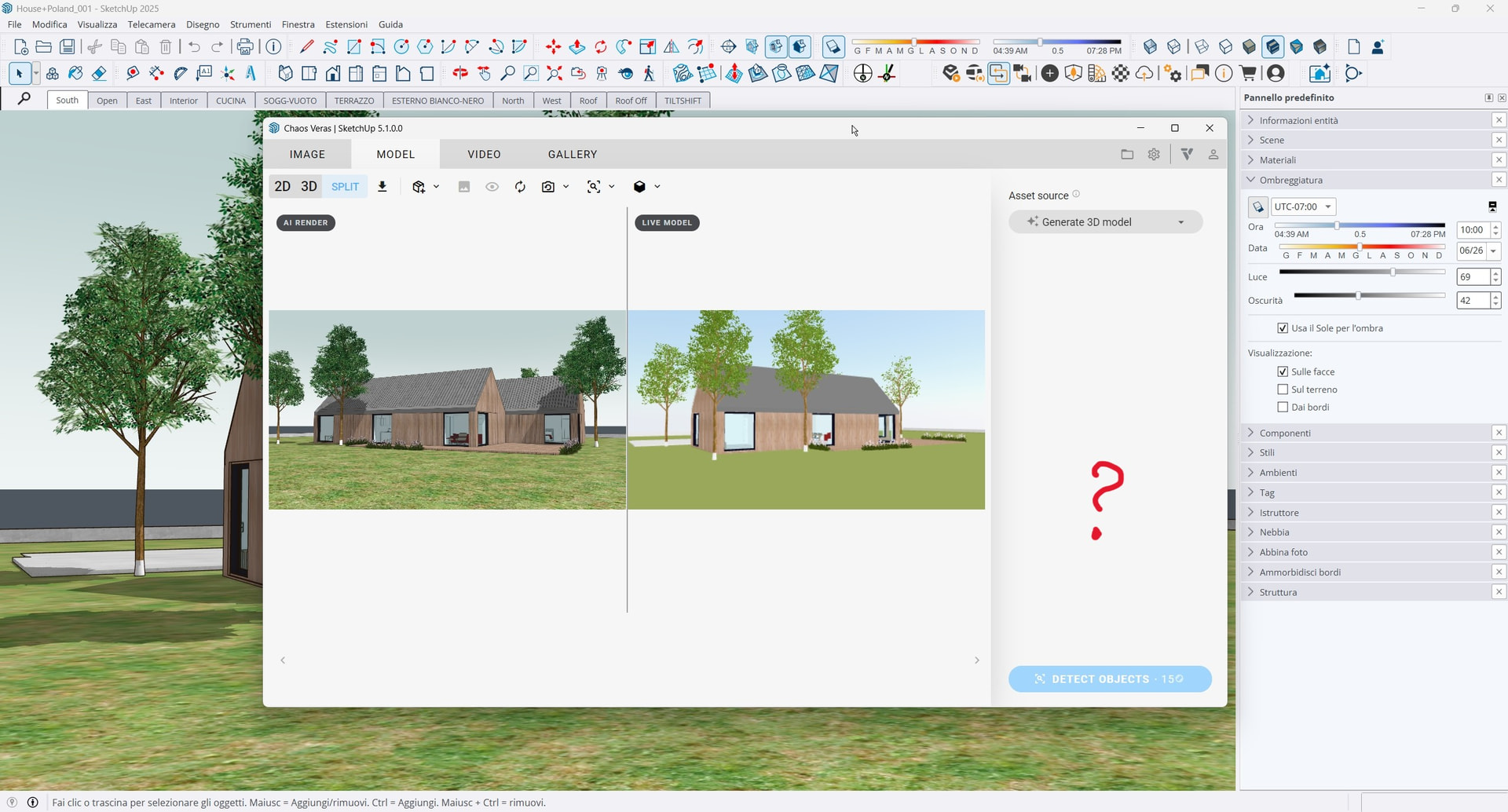

Thanks, that’s clear now. However, I installed Veras 5.2, but it still isn’t showing up in SketchUp…
What’s not showing up in SketchUp? the button to start Veras, or the Veras feature? please share a screenshot.
